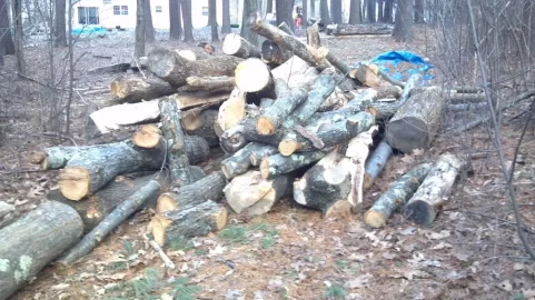

Looking for some advice about chain hoists, block and tackles. I need to purchase one. I have my new pile of logs in the back of the property that I need to start processing. I use a 4' one man saw, and a 6' two man saw to buck the logs. I want to be able to roll the logs to a poll with a block and tackle to lift the log so I can lower it onto my saw buck. Any one have any thing to offer on the subject?
