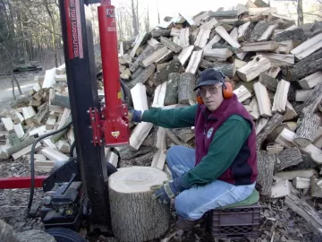

No, I am not bent over when splitting and do not understand why anyone would do that. My legs get lots of rest while splitting and I do not have to lift each piece to place it on the splitter either. I don't lift logs onto the splitter at all. I roll them onto the splitter. Much easier. In addition, many times while splitting I can have one hand on the control lever while the other hand is reaching for the next log to split. So I save my legs, my back and time.
I will state that we just do not split a little at a time. During the winter we cut the wood and just sort of stack it in rows but are not particularly careful stacking. Just so they are not thrown into a heap. Then it is a matter of placing the splitter alongside of the rows (we usually do this in March/April) and split away. That is why you see the larger pile of splits behind that guy. He has been splitting what he had cut the previous winter.
I am also "that guy". I split a majority of my rounds from the seated position too. I rarely lift any logs, most are rolled to the splitter and placed on one side (usually the left) so that I can get them from my chair. Afterwards the splits go the right, into a pile until they can be stacked. I rarely have any back discomfort but after a long day Advil is usually in order.
One thing for sure, splitting this way you get to touch&feel every piece. Hurts just looking. But then again, I'm Horizontal Only. If I have a piece to big for the log lift, never been in that situation, I reckon I'll go to plan B. To Each His Own. Happy splitting no matter how you get it done !

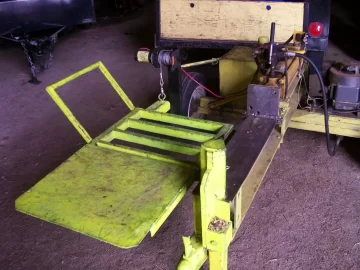

Jags, what kind of lift do you have and/or splitter with built in lift?
I'm really suprised there are not more small (20-30 ton) splitters for sale with built in lifts at a reasonable price. It really doens't cost much at all to add a lift to a standard splitter. You already have the hydro pump, all you need to add is a 2nd control valve (or upgrade the single valve to a double valve), a 2nd piston, 2 hoses, and a basket/lift. If the entire splitter can be made, shipped and sold for profit at $1k, how much can that cost more, $200?
Why can't we buy a 20 or 27 ton splitter with a small log lift for $1500 or so?
