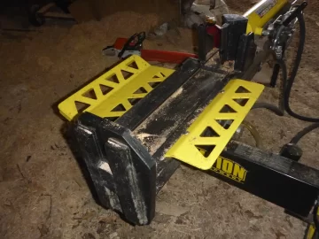

The log "shelves" are a bit flimsy and too small. I plan to make some replacements.

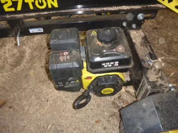

The motor is solid, but in a bad location. It is easy to drop a log on it by mistake. Also, the air filter cover does not stay in place, so I had to zip tie it to prevent it from falling off during use of the splitter. Also to shut off the motor, you have to reach over from the opposite side of the hydraulic controls.

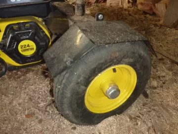

The fenders over the tires are a joke and bend easily with impact from a dropped log. I plan to remove them.

I have the 25 ton version and I really like it. But... the fenders broke right away so I removed them. I think it is better this way as I don't hit my shins on the fender edge. The control developed a leak under the screw in cap opposite the control lever. Champion immediately sent a replacement valve. Awesome service.

I keep this splitter covered. I observed one complaint that indicated water had gotten into the carburetor/engine from the design of the air filter cover. I think this is possible on this engine and my Predator brand as well, so my engines have a separate cover. I use a CLEAR tote/trash bag, as the rodents seem to like a dark place and so far there has been no nest building.
