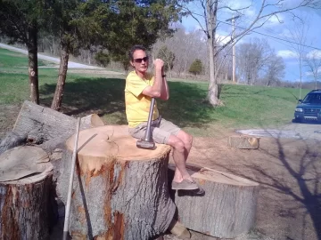

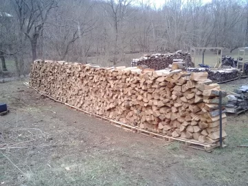

10 pound sledge and 4 pound wedges. Nuff said!;lol
[Hearth.com] Log splitting advice for the splitting enthusiast [Hearth.com] Log splitting advice for the splitting enthusiast
Reactions: Minnesota Marty
Ralphie....please tell me that is a "little person" sitting on that round :eek:
