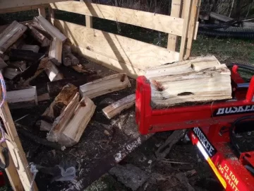

    Until i get a work side table this sorta kinda works.. Just splittin right into the trailer.
