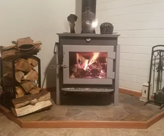

Looks like your in the Tahoe area? I'm down in Reno and ordered an Ideal Steel from Woodstock and it heats our 2300 square foot house from the daylight basement with ease. I love the stove and it can run all night with a good load of nice dry wood. Keep the far corner of the house upstairs and away from it at 73 degrees... It was $2300 with shipping and I picked it up at the local freight station in Mustang. Definitely a great stove to look into too.
***Edit*** Never mind me saying your in the Tahoe area.... Indiana your freight price for Woodstock would probably be even cheaper than Western Nevada where I'm at...
