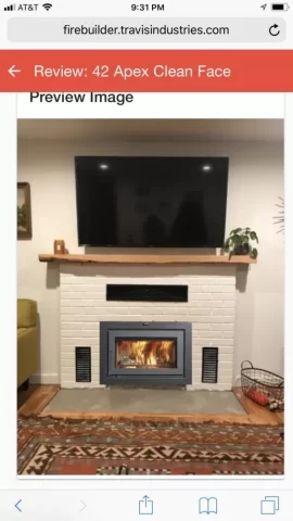

Attached a picture of my current fireplace(only picture I have is one with a insert photoshopped in... haha) . I just busted out the current tile on the hearth and we plan on tiling that soon. Before we put in the insert of course. I also will paint those vents white too. I find that they are pretty distracting painted black especially seeing it with an insert.
I really hope we can find some one to sell us the morsø. A place close by (Rich’s for the Home) says they sell it on their site but after talking to them they said they can’t sell the insert because it’s not WA certified...? But I know that’s not true... I was given a list of all the stoves that can be sold in WA and the 5660 was on there...
