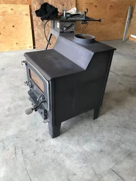

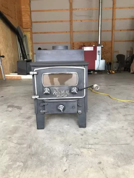

Any opinions on this old mill stove. A guy on fbook marketplace is asking $550 for it. looks to be in good shape. [Hearth.com] Looking for a good used wood stove[Hearth.com] Looking for a good used wood stove
I'd go for the Endeavor
Our T6 was 3 hrs away. Price was right, no regrets.
