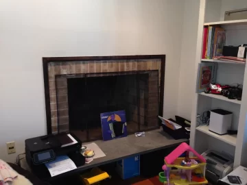

Problem to solve. The right side of the house, particularly the family room, and the bedroom immediately above it, while not cold, always triggers the house heat (heat pump/electric) to come on. I want to resolve this by placing another wood burner in the family room into an existing masonry fireplace. This fireplace is the same size as the one with my 5100i in it (about 40" wide, 28 tall, and 30 deep)

3. It cannot extend more han 10" beyond flush point of the wall. My hearth is built in (not changing it) and elevated off the floor. My quad 5100i comes out about 10" and leaves another 10" of hearth. It's about a foot off the floor. (if I went insert, I'd probably go flush anyway)

Here is a picture of the area we are dealing with. The record album set there so you can see the size and proximity to the wall.

I have a small jotul f 100 in my fireplace it works with natural convection no fan, in my opinion a wood stove is better than an insert. You need to make sure the stove pipe is insulated and there is a block off plate at the lintel. Good luck.
Thanks. When I installed the 5100i, I used a single, thick walled stainless steel liner top to bottom that was also insulated top to bottom. That insulation extended all the way to the connection on the insert. I'll assuming I'll be doing the same thing on this install. I also fabricated up my own flue block plate from 16G steel and sealed it around all sides with high temp caulk and tight at the pipe area. Working great there.
The jotul 602 was on my list to look at but fearful it might actually be too small to be worth it.
Keep suggestions coming please.
