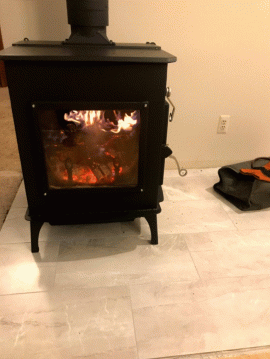

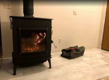

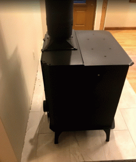

Here you go. I ordered mine back in.........April'ish??? somewhere around there. Had to do some remodel to get the hearth completed the way i wanted it, etc. The company is great to work with. I requested the handles to be painted a different color and they did free of charge.
I also paid extra for the rear heat shield so i could move it closer to the back wall.
