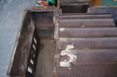

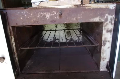

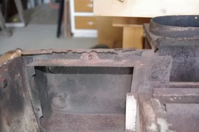

If my new little one puts out 27,000 btu's, I would imagine that the bigger ones will go much higher. What you really have to worry about is the internals on the old stoves. I picked up the little fella in the pictures here for almost nothing but you can see what the inside looked like once I tore it down. That's a project for this summer and then I'll either sell it will all new internal sheet metal or give it to my son for his shed.
Thanks for posting this. At least I'll know what to look for if I go out to check it out.

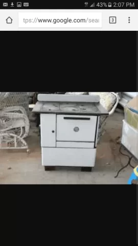

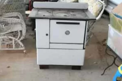

im not sure if you are still looking but i have this exact stove i would sell just let me know
