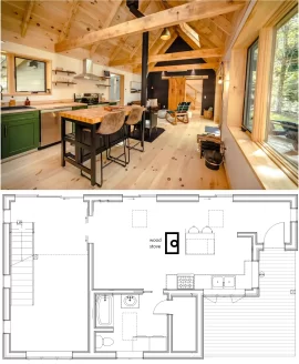

I'm currently under construction, building a small cabin.
Location: BlueRidge mountains in the south east.
800 sq ft main floor with a 200 sq ft loft, stick build.
Living room & kitchen area is roughly 600 sq ft, ceiling height is 18.5 ft.
Blueprint calls for a wood burning stove in the center of the room; can't place it anywhere else, as it would impact furniture placement. Bedroom & loft space is walled off from the living room past the black wall (pic below). Due to the main living area being small, I didn't want a stove that would be overbearingly hot to sit in front of. Got some great advice and have boiled it down to either a BK Ashford 20.2 or a Hearthstone Heritage. Interested in hearing from the wood stove crowd what you'd choose for this space.

Interior pic below is of another build of the same house plan.
[Hearth.com] So many choices, I'm torn between these models. Thoughts appreciated.

1. Have a ceiling fan or all the heat will be at the top.
2. I'm not sure how hearthstone stoves look from the back. BKs look rather industrial on the back side. I'd not want to look at the back of a BK. So either I'd add a half-high (up to the bar) wall there or if the hearthstone looks better, seriously consider that.

I’m not sure a Vornado will move enough air to keep your loft from being incredibly hot. But maybe it will. Hard to guess at.
If you set up your cabin like the pic, you may want to build a small waist high wall behind the stove. I wouldn’t want someone scooting a chair back into the stove. I could also see a jacket on the back of the chair getting dinged or lit up when ben it gets pushed up against it. The small wall would also hide the back of the stove from view.

With that type of layout I would be looking for a more radiant stove. Of those two stoves I would pick the Heritage. If you like the soapstone stoves look into Woodstock as well.

I might suggest whatever device you select for moving the air above the stove, you'll likely need to turn it off during initial lighting and reloads. All of the EPA 2020 approved wood stove models are very efficient and draft related issues can be challenging to detect. Air movement is one such obstacle as well as down drafts appliances, bathroom fans etc.
With this in mind, I'd suggest a remote control able device or perhaps a switch nearby to turn off the ceiling fan briefly during reloads.
As for back of stove appearances, I'd do as suggested, build a half wall and make use of the one side to build your wood rack. You could bring into the cabin 2-3 days of wood and the added conditioning time will help in stove performance.
