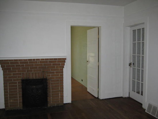

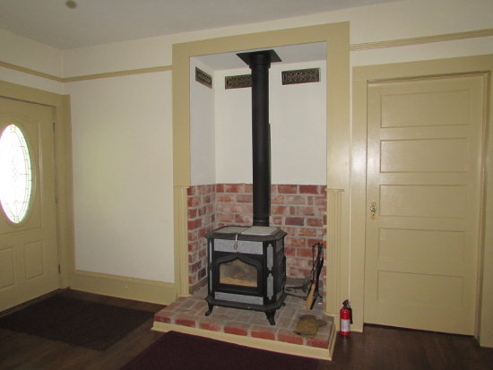

The things that stand out are the existing fireplace was converted into a heater hearth. which they installed a wood stove inside of it.
In my opinion there is also a lot of other useful discussion in the thread
Did you read the First post in the thread?
They took this
[Hearth.com] Looking for a wood stove, first time buyer, would like to get your advice
And made it into this

I also just think rumford fireplaces are cool and would provide the "ambience" which the original poster is looking for.

Yes but the op doesn't have a fireplace or a foundation for one. They simply have a chimney which was previously used for a furnace. So there is no fireplace to remove inorder to put an alcove in. And no fireplace to convert to a Rumford.
That is referring to a completely different posting. Read the first post in the thread.
So what you are saying is the original poster cannot get creative and create the space for something different? They cannot do these things?
I believe the Original poster could make something like what i posted.
Converting what they have would also allow the wood stove to sit further inside the wall and protrude less.
