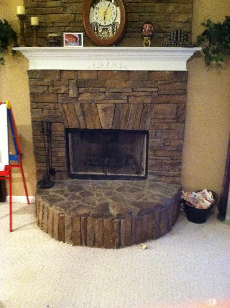

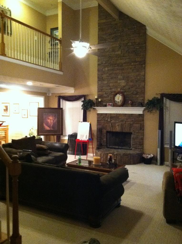

Im a rookie and want an insert for our majestic 36. Ive looked at several buck stove model 18. It will fit with ease. The stove just looks to small IMO and im not sure it will keep up with our open floor plan. Any other suggestions as most installers in ga only carry buck and a few others and the buck is all they have offered. The house is roughly 3000 sq ft and the buck only heats 1200 but it has to be better than the fireplace I have. Open floor plan with 20 ft ceiling in living room where the buck would be located. My opening in the fireplace would be front opening 32" back 20" height 181/2 and dept to face of rock 19". We dont want a free stander. Thanks for any advise.

With only 18.5" in height your not going to get a large enough insert to heat that ceiling height. Sorry, but a free stander on your hearth with a rear vent will do a nice job for you.

Thats what I was thinking. With the round hearth i measured from the left edge of firplace out to the edge of hearth and its 26". From the center its 31". Any suggestions what stove we would need to sit on the hearth.

I would take the hearth off the front and the floor out of the firebox if possible. Then build a new hearth at floor level and put a free standing stove in or in front of the heightened firebox.
I was thinking a Lopi Freedom or Revere,but I think you need more height.I think Oregon's idea is great.

Can't comment on a full tear out or free standing. However I can comment on the Napoleon 1402. I recently installed the 1402 in my 2500 sq ft home that is not air tight and not the best layout. The stove does the job. I can't get 4-5 hr burns. However I would be concerned about that ceiling height and size of a room. The twin 100cfm fans do a great job of putting out the heat but my living room is only 600sq ft with 9 ft ceilings and with the stove roaring I can keep it 74. I know it all depends on layout, etc, but my brief experience tells me you might not get what you want out of that insert with that size room...
