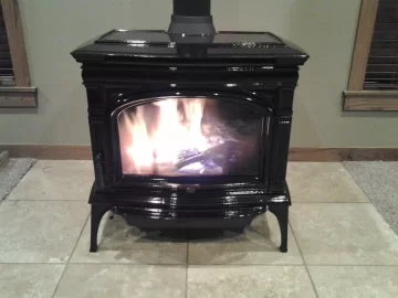

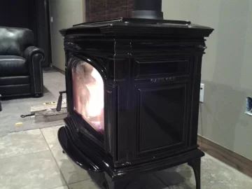

I've had my Cape for 4 days now and really love the look of it. I haven't loaded it all the way up yet, it's my first stove and still trying to gain confidence. Plus, I'm waiting for it to be added to my insurance before I fully load it and can leave so I don't have to watch it for hours on end. I went back and forth on the color and went with the enamel-glad I did. It is a very dark brown, almost black. It looks like a piece of fine furniture. I also highly recommend the blower, it pushes out the heat much more than the natural convection out the top. You can vary the speed and it turns on and off automatically with the rheostat. Don't have the autostart feature.

Thanks webby,several questions for you. From a cold start, do you just get a good fire going with a few splits then fill it up, or fill it up from the beginning? Also, how do you know when to shut off the bypass and decrease air? The manual gives no info on temps, just says if it starts glowing it is too hot. All I have so far is an infrared gun from work and point it at cast base of flue and up the pipe since the top is separate, only reached 350 so far on a small fire. Would you or have you filled yours up with 100% oak?
I fill mine up nearly everytime. I rake the coals around to remove the ash and then fill it up. Sometimes I use pine and Tulip, if it's cold then I use Oak or Locust. When I start from a cold stove, I do a top down fire. Splits on bottom, kindlin and firestarter on top. This way makes a nearly smoke free start-up.
When the Cod is cruising where I want it, the flue collar base will read 650 with the IR. It's the most controllable stove I have ever used. Now, fill it up!::-)
