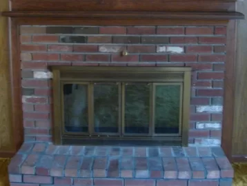

You're probably right, so here you go! I have not made the measurements yet, but I'm not sure it would fit a stove (my 13NC seems like it would be too high).

Is it all masonry inside, or is it a pre-fab steel firebox? Rick
Fossil,
It is all masonry except for that trim/door assembly. It tapers back on the inside.

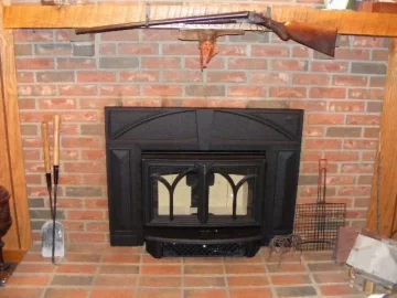

SML, Pretty similar situation with my fireplace, as it is in our main television home theater room. Similar style fireplace also. The noise level of the fan does not seem to be too excessive for us. We think that it looks more finished than a stove stuck in the fireplace. Heat output has been eccellent also.
