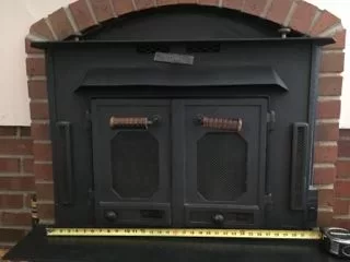

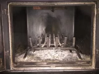

Question: If all you are burning are sawdust logs (prest logs, one log at a time) in an old Buck Stove wood burning insert that has been used for years with no problem inside a 1980s built red brick fireplace and chimney without a liner, and there is no creosote in the chimney (since not burning wet/green wood), then do you "really" need a liner?

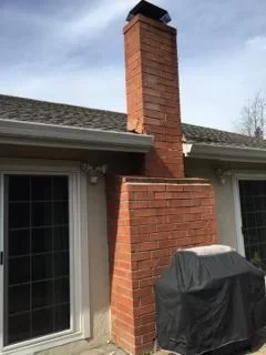

My chimney has dry stacked terra cotta titles inside and virtually no creosote built up. I'm understand in our litigious society these days to "err on the side of safety" and give "text book CYA answers", so appreciate some realistic balance with some engineering safety logic vs. arbitrary "not 100% safe" that doesn't seem to pass the gut check.

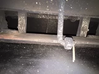

PS: Here are some pics of my setup

Slammer install, that's not a code compliant install anymore >20years. The main issue other than creosote formation due to excessive temp loss of the smoke due to the volume size of the chimney in relation to the stove collar size is the that its a none sealed connection. My worry is that after the fire goes to coals and the chimney cools down even more (more so on shorter chimneys) or a fire going but very cold and windy, a down draft setting up and leaking CO into your living space. A liner can help you with keeping more heat in it, keeping a positive draft through all three stages of the burning process.

Guys, did we establish the install is a slammer and not a direct-connect? I can't tell that from the pics. The OP only said he didn't have a liner, but he did not say he didn't have a length of stove pipe going up at least past the first flue tile.
IMO, a direct-connect is sometimes okay (even if not advisable) but a slammer w/ no pipe is NEVER okay, even if the insurance company says it is... which seems doubtful.
