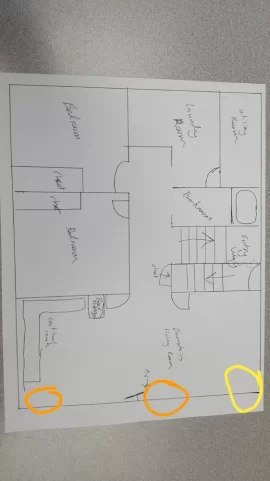

I will snap some pictures tonight, here is a picture of the basement floor plan with possible locations. The preferred spot for ease of installation with existing furniture and without moving existing wiring for outlets and cable is in the corner of the living room circled in yellow. 2 other options are in Orange, but would require moving wiring for the tv, and I believe the sectional couch may be too close for the other (unfortunate as it's my most desired location as it would position the chimney on the back side of the house opposed to on the front)

That looks like a logical location. Is the proposed location for pipe going through the wall below or above grade? At that location will the chimney pipe that goes through the wall be going through a cement or wood studded wall?
It will be above grade by 2 feet or so, through a wood studded wall with sheetrock inside, spray foam insulation and vinyl siding outside.

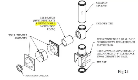

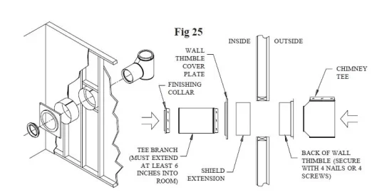

Very good. It will need a wall thimble kit by the mfg. to pass the chimney pipe through the wall safely. The installation will look something like this
[Hearth.com] Looking for my first stove [Hearth.com] Looking for my first stove

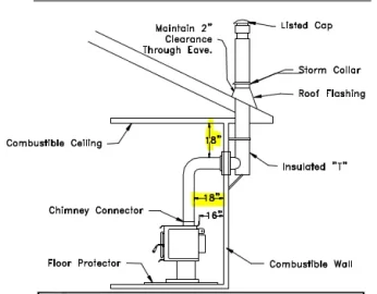

The whole install will look like something like this:
