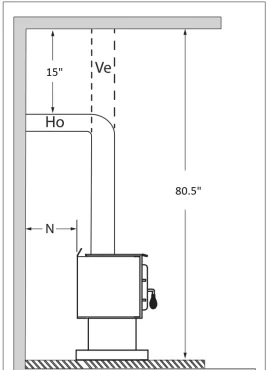

I am mainly trying to figure out clearances now. I want to use an existing wood stove hearth area in my finished basement, but the height to ceiling on the hearth platform is 80.5" and the pipe that goes to the chimney is 15" from the ceiling. All of side clearances check out in the manual for 78" height to ceiling. but I thought I needed 18" from the top of the stove pipe to the ceiling for it to be right.
Attached is a pic of what my current setup would look like.

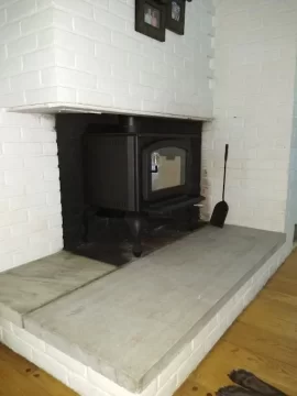

We had an existing open hearth on 2 sides, it was really the best choice to fit in the more confined space.
Its a great little stove, but the key word is little - the firebox is only 2 cu.ft., so there is no overnight burn...plan on reloading every 3-4 hours if you want to burn it around the clock. We use it from bell to bell and the let the furnace take the load at night (set the thermostat to 58-60), last load usually about 10 PM.
That being said, we cut our fuel oil bill by 70%, so its more fits the bill for our situation (space, oil-fired back-up, etc.)

Got the stove inspected/approved yesterday. Very pleased with my first burn, chimney drew like a charm and had no issues lighting or getting things started. Thanks for all the recommendations and advice on the install.
