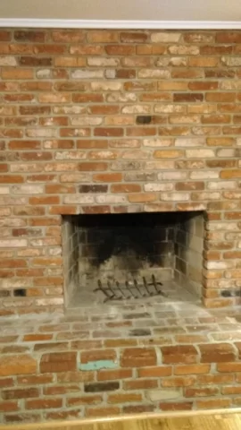

Per the subject, I'm in the market for a wood stove and figured the wise minds here may have some good input. In my previous house in New England I heated exclusively with a Hearthstone Clydesdale wood stove insert, but this go around I'm only planning to burn for supplemental heat, am looking to save money, and am thinking of installing a freestanding stove in a masonry fireplace (see picture). Fireplace dimensions are D-23", H-30", and W-34" in the back, location is the basement, and house is a split level just under 1800 sq ft in Northern VA. I do plan to increase the insulation and sealing in the house in a year or two as well, so a slightly undersized unit may not be a big deal.
I currently have my eye on an England Stove Works stove, the 50-TNC-13, which I can get for $600 reconditioned + tax. Any reason why this wouldn't work, or is there something that may work better without being overly expensive (>$1200)? From my research, England Stove Works, SBI, Hearth and Home Technologies, and GHP group all make good quality stoves that are a good value and have good part availability, so I'm leaning toward those manufacturers.

Honestly, I wish the 50-TRSSW01 came with legs or a shorter pedestal so it would work with my 30" height limit as I would prefer a deeper firebox. While the 30-NC works with my dimensions, I feel like its a monster for my use case.

I was not able to edit my original post, but the height on the front 3.5" wide lip of the fireplace is actually 29.5" possibly causing an interference depending on if the stove top is 30" or the flue collar is 30". To begreen's point, even if this stove could fit, it would be so tight that moving it to connect the liner would be challenging if not impossible. But with the fireplace lip only being 29.5", even the NC-30 could have challenges getting in.

Stove height is the issue. The 13-NC may be the best affordable bet that fits. A bigger insert would also fit, but it will cost more.

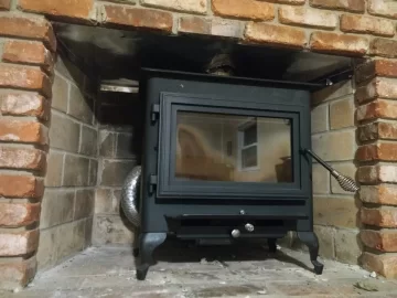

I ended up with the Englander 13 model, and honestly haven't even bothered with the ash pan given how shallow it is. I may try it sometime just to see how it works, but sounds like the new model was poorly designed.
Also given I installed inside a fireplace I stuffed a bunch of rockwool up the chimney and made a blockoff out of steel flashing. Tube on the back is outside air - although I probably should have put the hole farther to the left. This little stove puts out some serious heat.
