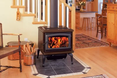

I'm not sure why the requirement for a sheet metal enclosure. Why is this important? You might consider a Pacific Energy Summit Classic stove in that case. It has a very nice porcelain coated steel jacket around the stove body. But the front door has glass and is exposed. This is a huge advantage for increased radiant heat and a wonderful fire view which many think is one of the best features. You can choose the color of the cabinet and the finish of the door and legs. Here is one in brown with a black door and legs.
