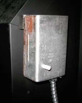

After all was said and done, I ended up using a Honeywell fan control/limit switch.
Looking at the parts list and the exploded view, it was difficult to determine how
much room I had inside the hot air plenum for the switch probe. I drilled a small
hole in the top section and determined that a 5" switch would work, as long as I
installed it at an angle. I cut a 5/8 hole (I had to file it out to accommodate the
angle I wanted to maintain). I made a bracket to hold it in at the correct angle.
It's not so much that I wanted to be fussy about it, I just didn't want it to rattle.
I didn't use the "limit" portion of the switch, just the fan control with "ON" set at
160 or so, and "off" set to 120. I used a small piece of BX to run the wires down
to the "handy box" on the fan. The "hot" AC lead went to the rheostat so I switched
the neutral side. It works pretty well. Nice thing about this switch is the ability to
just switch it to manual if I want. Here are a couple pics. If anyone has questions,
ask away. As you can see, it wasn't a new switch, but it was free... Free is good!
Thanks,
Mike Pelletier

Doesn't it just figure?
I was speaking with my brother-in-law who owns a stove shop in Lancaster, NH. I told him about the switch
I'd installed to run the fan only when the temperature of the stove made it worthwhile. He smiles and told
me about the FT-1 magnetically mounted temperature sensor/switch..... Apparently it mounts to any metal
part of the stove and will control the fan. So much for my best efforts. I wish I'd checked sooner.
I couldn't find any information on the internet for it, but from what my brother in law says, it's available for
about $75. Sounds like a deal to me!
Nah, it's more fun to build your own stuff anyways. I still have to put mine together but it won't be long. Besides, what would I do with all that down time if I'm not trying to reinvent the wheel!
