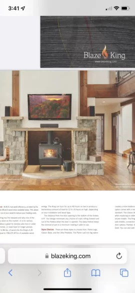

The BKK has much smaller clearances and would work in the alcove as shown….
Decisions decisions.
Does a ZC give a better flame view than the BKK or is the BKK good other than at low heat.

BKs are comparable in heat output to other modern stoves with the same size firebox on the high end of the range (the occasional user suggests BKs are putting out slightly less at high burn rates than others, but efficiency numbers don't back that up).
They have extended the low end of the range. However, while there is a nice flame view above halfway settings, the low end of the output range is rather dull. We call it the black box mode. Smoldering with the cat providing the heat and cleaning up the smoke. No flame then.
If flame is a must at all times, don't do a BK - at the cost of more frequent reloading (because smaller fires to lower heat output while still burning hot) or more cold starts (batch mode).
Yes, several ZC fireplaces have a much larger viewing area and higher heat output.

I'd spend the extra on these house upgrades way before spending it to build a "fireplace" or alcove...the upgrades will pay you back 24/7/365.
If you like the look of a stone fireplace, just sit the stove on a elevated stone hearth and do a faux stone wall behind it...through the wall pipe will limit the exposed pipe, just make sure to exit high enough as to not limit future stove choices too much.
Just make sure you get the approval of the spousal unit before commiting to a BKK...
