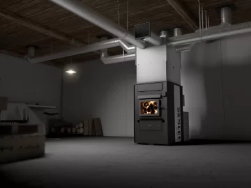

Would a HeatPro be an option? Doesnt seem like the ambiance matters to you, just the heat.
