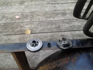

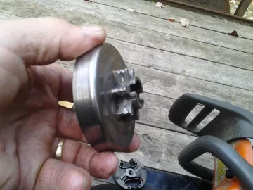

    Ok, here's the deal.
    I'll be on Youtube to get a handle on this, but looks pretty straight-forward to replace.
    Forgot to mention that I also took apart the adjuster and everything looks ok. Gears are fine, but the adjuster bottoms out and the chain is still slack. Can't even pull the bar tight enough.
    Perhaps I'm doing something wrong?
    Should have taken pics....I can do that if it would help. I have a feeling some of youse guys:cool: have seen that already.
  21. bogydave
    bogydave
    Dec 4, 2009
    8,426
    3,446
    So Cent ALASKA
    Looks like my old one. I replaced with the rim type. Mine was worn a little worse.
    Did you lay the new & old bar side by side & are the same?
    New chain or old chain won't get tight?
    Count the drive links on the chain, should have 72. It's possible that when the chain was made it has an extra link.
    I have one with an extra link on my 14", it's ok now, but am near the end of adjustment with it & it's almost new.
    If old chain, remove a drive link or a new chain. I vote replace with a new chain.
    Could be too, the old chain is just stretched that much.
    You are on the right track & seem to be doing it right. Some new parts & I think you'll be good to go.
    Same learning experience I had when I had bar, chain & drive sprocket problem.
    If I can fix it, anyone can. Utube, new parts & the saw gurus here got me thru it.
  22. PapaDave
    PapaDave
    Feb 23, 2008
    5,740
    2,222
    Northern MI - in the mitten
    Thanks again Dave.
    The new-er chain that's on there now was fine when I first put it on (whenever that was), but now gets loose and slips off the bar (even the new one:mad: ), so I'm thinking a new rim sprocket, and maybe a new chain too. If the local hardware doesn't have anything, I'll order online. Bailey's has the rim sprocket for $21.
    After watching a couple (or a whole bunch) vids, I now realize the rim sprocket can be replaced w/o doing the whole thing and should be less $$$. Good thing.
  23. amateur cutter
    amateur cutter
    Aug 20, 2010
    1,170
    714
    West Michigan
    Dave, that sprocket is toast, but I'm not sure that's the whole problem. As BD said, check the number of drive links in your chain, & look at them closely, that sprocket may have damaged them. Another option may be an 8 pin rim to go with the older chains, it's a bit larger diameter & will take up a link's worth of slack. You'll get a little more chain speed, but sacrifice some power. A C
  24. bogydave
    bogydave
    Dec 4, 2009
    8,426
    3,446
    So Cent ALASKA
    Slipping off the bar is a prime sign the sprocket is bad.
    The sprocket gets worn & doesn't align with the grove in the bar, the chain jumps off . Mine did that several time & I didn't know i had a problem until I' was where you are now. Worn sprocket & a new bar.
    Then a new rim sprocket kit, & a new chain. Oregon dealer said the badly groved sprocket screwed up the chain's drive links. Was my first chisel chain & now that's all I use.
    After all that, I started researching getting a new saw. About 8 months later I got the 359.
    Same 20" bar, chain etc.
    Of course my saw was a 1982 husqy 61 with a few missing parts & a broken chain brake.. A few years older than yours.
    Still runs fine but the 359 is lighter & starts easy & idles.
    If I started looking today, I'd look hard at the 562xp, may sell a few cords of wood to help pay for it. It looks cool & specs out high on my list.
    4.7 hp & 12.7 lbs ;)
    http://www.husqvarna.com/us/products/professional-chainsaws/562-xp/
  25. MasterMech
    MasterMech
    Guest 2.
    I wouldn't do an 8 pin rim on a 455, just not enough saw there to pull 20" on a 8 pin. The sprocket pictured was done a long time ago. Once you see the grooves start to the left and the right of where the drive link contacts the sprocket, the sprocket is cooked.
    If you're running an old chain that has stretched to the point of not having enough adjustment to compensate, I'm not sure I'd trust that chain in the wood. There should be no discernable movement in the rivet joints other than rotation. If you can compress/strech the chain, junk it. It's not worth having it break and come flying out of the saw doing 45-50 MPH for your legs.
    You want rim sprocket nirvana? Saws that have inboard clutches, I can swap rims in mere seconds compared to having to remove the clutch on an outboard clutch setup. Don't need any special tools other than what's always on my belt (Leatherman) or what I normally carry in the woods. (scrench and small screwdriver)
