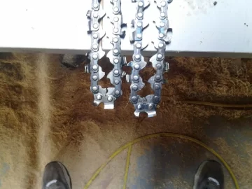

    Oh, and it looks like the new-er chain DID stretch. Here's a pic of the original (Husqvarna) chain (L/H) and the new-er one. I might take it to the hardware and have them pull a drive link.
    Any thoughts? 1010121340.jpg Both chains have 72 d/l, and are perfectly lined up at the other end. The difference is about 3/8".

    You should have enough adjustment. If its strecth that you cant adjust it any more, get rid of it. Nothing like a chain breaking to wake you up!

    Thanks SJ.
    I'm going to try it with the rim and if still the same, it's in the trash. Might go in the trash anyway. I can get a new chain for $15 at the hardware.
    I don't need to go to the ER again.:mad:

    The stretched chain is 20", 72 d/l, 3/8"-.375". The original Husky chain is also 20", 72 d/l, 3/8"-.375". Those were the ones in the comparison photo.
