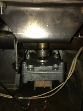

has anyone in this Forum has to remove a metering auger motor on a LOPI AGP Pellet stover or insert? I have an insert. I removed the socket head cap screw. Now just trying to figure out how to remove the motor.

Probably figured it out by now, but posting for other people who might find this in a search:
There is a Hex Bolt on the silver cuff right below the bronze cuff in your picture.
It's probably pointing directly away from you so you aren't able to see it.
Undo that nut and the motor unit will drop down.
