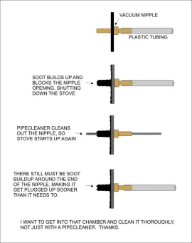

After having an Austroflamm for 22 years, my wife and I bought a Lopi AGP (freestanding). This is our second year. Recently, the stove started shutting down after 2 days of running even though I had given it a thorough cleaning. I know how to get it started again easily. I just take off the right side panel, disconnect the vacuum hose from the nipple and run a pipe cleaner through the nipple to clean out the soot. The stove starts right back up every time.
What I think is happening is that soot is building up around the nipple on the other side of the wall so that it is easier and easier for soot to plug up that end. The problem is that I can't get into that chamber to clean the other end of the nipple. If I try to access it from behind the ashpan (I remove the little trap door), the fan housing is in the way. My only other option would be to remove the combustion fan from the vacuum hose side and reach in through the hole to clean the nipple and as much of the chamber as I can see/reach. I haven't done that because I don't know if I would be breaking any seal between the fan and the wall.
So I have a couple questions: 1) Am I right about the stove shutting down because of soot in the nipple? and 2) If that is the cause how can I access the other end to clean it? I'm attaching a diagram of what I think is happening. Thanks in advance to everyone responding.

1) Am I right about the stove shutting down because of soot in the nipple? Yes it is quite possible that is your problem.
2) If that is the cause how can I access the other end to clean it? if it is a brass barb bulkhead fitting like what the picture shows there should be able to remove the fitting with a wrench from the side that you can access. if it isn't its more than likely welded into the bulkhead and pipe cleaner or removal of motor is necessary. should remove the motor at least once a year to clean it out maybe more depending on pellets and how dirty they burn.

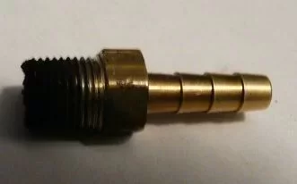

Today I followed Ssyko's advice and took out the vacuum nipple. The end that's inside the bulkhead had quite a bit of soot on it. I cleaned it as best I could (is there a solvent for soot?) and reinstalled it. As I said in the original post, there's a small chamber on the other side of the bulkhead which I'm sure is loaded w/ soot and contributes to the nipple getting plugged. This weekend I'll be taking out the combustion motor (which is next to the nipple) and try to use the hole for the motor to get a brush in there and knock down some of the soot. Unfortunately the combustion fan has a housing around it that may block me from accessing all corners of the chamber.

Never cleaned one,but think you are right,a small area that can get buildup in it.Pull the blower,and have a smaller section of hose adapted to your vacuum cleaner.Duct tape works in a pinch.

Just an update, but after removing the nipple and cleaning it semi-good, we've been running the stove four days without a shutdown. Tomorrow I'll be taking out the combustion motor and cleaning out the chamber as best I can.
