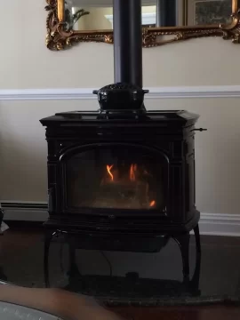

Thank you. I will post a picture with this reply, but not a spectacular fire at the moment, just a small one. We have used the stove just about daily, and everyday since November. We had a real cold spell (for around here) that lasted about 7 days and never got above mid 20's. Never had to fire up the furnace though! We just kept stuffing wood into the Cape Cod and it never let us down! Temps are much milder now, upper 30's at night, and lower 50's during the day, as an average range. I tend to keep small fires during the day, but mid to upper limit draft to keep the temps up. At night I stoke it up pretty good, and after it gets good and hot, shut it down. I usually have enough coals in the morning to start another without any kindling.
Wow, that looks great. Glad to hear you are having such good results with the Cod.

Wow . . . very nice looking hearth Cherr.

Beautiful looking stove. The fire show is amazing. Thought about the Cod but went with something else. Glad it's working out.
Nice looking stove! We had thought about getting the porcelain coated version, similar to the color on your stove, but we went for the plain version. In our previous home we had a Quadra-Fire Voyageur Grand insert that was porcelain, and it sure looked great. Worked extremely well with the built in fan an auto-off feature, but not so convenient to clean out as the free standing unit we have now.

I really like your hearth. The stonework looks great. I've been setting tile all week and would love to rebuild my hearth to match yours someday.
