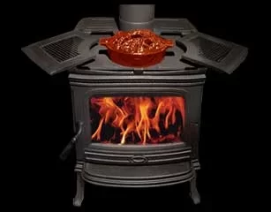

Don't forget the Woodstock Progress Hybrid comes with a cook top,,, you simply just lift the three top stones up . Has three marked areas for pans..when your done, you flip the stones back done and now your back to a regular looking wood stove, plus it has an optional ash pan which is huge.... I agree, I think the Cape Cod is a really nice looking stove...

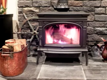

Welcome and thanks for the report cherr. If you can post a picture of your stove, we'd love to see it in action. Are you burning on these mild mid-50s days? If yes, are you able to burn low and slow in the stove? What are the burn times like for you?
I'm glad it's working good for you. How long have you had it? I'm assuming this is still the first season for you? I see now you said August 2014. We'd love to see a picture of it!

Thank you. I will post a picture with this reply, but not a spectacular fire at the moment, just a small one. We have used the stove just about daily, and everyday since November. We had a real cold spell (for around here) that lasted about 7 days and never got above mid 20's. Never had to fire up the furnace though! We just kept stuffing wood into the Cape Cod and it never let us down! Temps are much milder now, upper 30's at night, and lower 50's during the day, as an average range. I tend to keep small fires during the day, but mid to upper limit draft to keep the temps up. At night I stoke it up pretty good, and after it gets good and hot, shut it down. I usually have enough coals in the morning to start another without any kindling.
Beautiful looking hearth and install there. It looks great.
