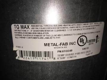

Not sure what I am looking at here. I thought the Freedom was an insert. Do they also make a ZC version? What type/brand pipe is that on insert?
[Hearth.com] Lopi Freedom Burn times...........Air control adjustment
Reactions: velvetfoot
I have a Lopi Liberty and a similar house layout. These stoves just don't close down like the old stoves did, even with the air control "closed" it's still open enough to minimize smoldering. I'm sure it's all driven by the EPA and in my case, WA, emissions limits. My folks had an awesome Lopi stove when I was a still at home, these newer stoves are nice but you can't shut them down and the tubes take up valuable box space. I try to load N/S overnight as I feel I can pack it tighter and have more morning coals to work with.
Yes, it is an insert. Mine has a "block-in" install around it. Those are blocks around the insert, then chimney was framed around that, and then stone laided on top of framing. The pipe is double walled stainless, not sure the maker, I would have to look it up.
Double walled stainless stove pipe, not chimney pipe?
The first year I had my Freedom, I had the same questions you have. I talked with a bunch of Freedom owners, too, just like you are doing!
After 4 years, and corroborating stories from other Freedom owners here is my experience. (FWIW, I have never tried to modify the air intake.)
The 12 hour burn time advertised is very misleading. I get a max of 6 hours of good heat output when the temps are in the 20s. I'm heating about 2400 sf. My place is decently insulated and air-sealed, but yours sounds like it is much tighter.
I interpret the 12 hours to mean restart without a match. I have leftover coals at 12 hours, but not usable heat.
The Freedom is a beast of a heater, but long burn times with usable heat are not happening. Personally, I don't mind waking up to a house at 65. It's nice sleeping temperature. I can get the temps back up to the 70s pretty quickly.
From my experience and others that I've talked to, your situation sounds normal for the Freedom.
Thanks for your input. At 6 hours I have no usable coals. I am starting a fire from scratch. At 8 hours in my revere that I used to have I would have plenty of usable coals. Throw some wood on, open the air control, and it would be burning hot in 10-15min.
Got it, that's chimney pipe. I've never seen an insert installed this way.
What confuses me is that I thought in order to qualify for a masonry fireplace there should be 8" masonry surrounding the insert. Otherwise how were clearances to combustible framing established?
It is a little hard to tell in the picture, but it is surrounded in masonry. There is two layers of block its sitting on and 8" cinder block on both sides and back and top. Then its covered in concrete mortar. Then the framing was framed up to the cinder block.
Thanks for the clarification. The end result looks great.
