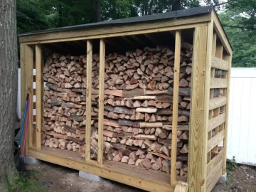

since i only decided to buy a stove 2 months ago, my first goal was to get aggressive on wood storage and accumulating wood. I built my wood shed last month and just ordered 2 cords of "seasoned" . I split a couple oaks a few months ago but ill burn those next year. The 2 cords I had delivered i hoped to burn this year, will i be completly screwed this year? what should i expect for performance? will i have issues with creosite or anything? thanks for the info and honesty.

Don't be afraid to reject a load of wood. Before they unload the truck, grab a few random splits off the truck and examine them closely. Look for greyed and checked ends. Feel their weight, are they too heavy? Knock a pair together, do they give a thud or do they ring with a musical tone? Thud indicates unseasoned. Resplit the splits and press the freshly split wood against your cheek. Is it warm and dry or cool and damp? If you have a moisture meter use it on the freshly split face of wood and check.
If the load of wood is partially seasoned and it is wood that dries quickly (like ash) then you might get enough drying time by fall. It depends on how much dry wind can blow through the stacks.
Find a tree service tell them you would like a load or tow of soft woods or maple. Usually they sell the better wood themselves(oak, ash, hickory ) but have to pay to dump the less desirable wood(cotton wood, pine, maple) if you can get some of that, get it split and stacked quickly in sunny windy places in single rows with topcover you should be good to go this year. I'm in my second year burning and that has been my plan. Now I'm good to go for the next couple of years and can start getting pick about my scrounging
I love it, but you should get what you plan to burn this year in the sun and wind in a single line, then you will be good to go.....what exactly do you have?
There is always the remote possibility that you did get properly seasoned wood, but the overwhelming experience of so many others here suggests otherwise...
If stacked and split now, several species will be dry enough to burn without too much trouble this season, but oak and hickory will not. The oak you split this spring might be dry enough in 2014/2015, but will be great by November 2015. I'd sort through your two cords and take out any faster drying woods, stack them in a single row in the sun, not in that nice shed.
Wet wood will cause overall poor performance, less heat, shorter burn times, more wood consumption, and more creosote. Modern EPA stoves are far more sensitive to wet wood that older stoves. I burned 6 month old oak in my old insert, but a year later could barely get that same oak to burn in my new Lopi.

I switched to an EPA stove Oct. '12, burning red oak that I c/s/s in Feb '12. Certainly not ideal but I had no problems. 30+ years of burning green oak in a pre-epa might have helped. You can expect more creosote and smoke, less heat and efficiency with green wood. Keep stocking your wood supply. Seperate fast drying species and stack them in single rows in the sun/wind, as suggested. You can also supplement with biobricks or pallet wood. The first year is the toughest, all down hill after that. Welcome and good luck.

My cotton Wood and Pine gets Double stacked, it is already almost ready to burn after 2 months everything else gets single
