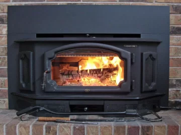

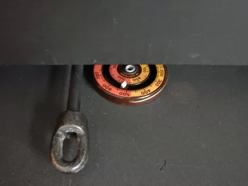

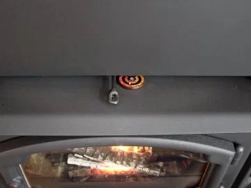

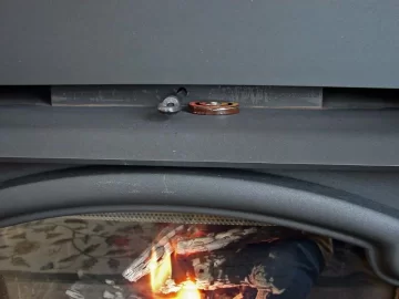

Here are some pictures of where I put the stovetop thermometer. I included an IR photo from over a year ago so it does not correlate with the temp reading pictures of today. The IR shot just lets you see the hottest spot. My thermometer is actually within 20 degrees of the IR.
View attachment 87348View attachment 87349View attachment 87350View attachment 87351View attachment 87352
