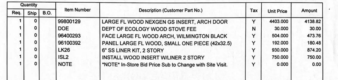

I am looking to purchase a Lopi or Fireplacex Large Flush Insert. There isn't many dealers in my area. The highly recommended dealer was $6500 for just the fireplace. The install was $1800 for a uninsulated liner. They said the insulated liner wasn't needed in my area since it doesn't get that cold(outside Philly). The install sounds fair but I have no idea on the fireplace cost but sounds really high. Did you pay? Does anyone sell online? I couldn't find anyone.
This is one of the few inserts that will fit my 47"x30" opening without a custom surround.
Correction: It was $5500 for the insert and $1800 additional for the install with uninsulated liner.
For that same insert In NC I was recently quoted 7.5k for everything after tax. That’s the insert, backing plates, and insulated 35’ liner installed after tax. Some places offer a cash discount. Seems prices are only going up. Had one guy quote me $250 for Gas and travel time, granted I do live 1hr 15mins but still that scared me away from buying out of town.
