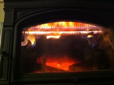

I could make you a smoking deal on a Lopi Cape Cod.
Why are you getting rid of the Cape Cod? It was one of the stoves I considered before getting the Oslo, so I'm curious why it's being replaced.
webby has a brand new toy, a BK Ashford.
