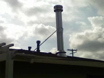

OK guys. Here is the pic Jamie sent me of the pipe. Hard to tell from the angle but it looks like the installers were trying to be higher than the peak, not just a point ten feet away from the stack.
What do ya think? Trying to clear the peak? Didn't have a piece of shorter pipe for the second section? Did if perfectly?

Hard to say for sure, but to be honest, I'm not sure taking 2' off that is really going to make all that much difference from an aesthetic point of view.
Leave it....big shiny smoke stacks are cool.
It doesn't seem to be any taller than the rest of the vents on your roof.
What is the distance from the peak of your roof to the chimney, both horizontally and vertically?
Really hard to say. From the angle of the photo, the roof pitch looks very shallow.

the angle of the photo indicates to me he has a 5 pitch roof, that means for ever foot up that roof is 5" taller
times 10' he needs 50" just to be even plus 24" to be above the 10/3/2 rule or 74" to the outlet. It appears he barely meets compliance
after 4' additional support is required which his installerd included the require bracing So I gusee if you install the chimney correctly there is a groan and when you skimp on height there
is a groan. Really when you hire someone to do it right, as it appears, then what' to groan about
Thanks for all the help. with the picture doesn't really do it justice. I just think it looks too tall. I am stuck here at the fire station, so the pictures are from my wifes phone. I will evaluate the stack in the morning. I do live in san diego, and the stove is for heating, but more for the romantic interludes by the fire.
