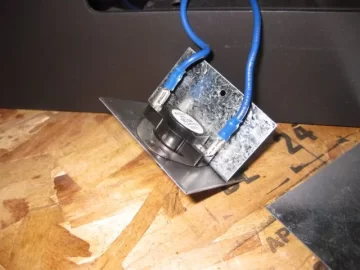

Well, I finally got the snapdisk to snap.
I removed it (see pic), took off the metal protective box that was around it. Used gorilla glue to glue two very small powerful magnets to the face itself (on the other side of what you're seeing in this pic). Let it harden overnight.
Slipped it back inside the fireplace (whoops... should have hit the breaker: I touched metal and blew the breaker instead, causing me to jerk pretty good), put it right under the firebox (and the magnets held it there perfectly).

It tripped in about 45 minutes or so Nice.
I'm still going to try to replace it with the newer one I ordered because 45 minutes is a lot of heat to waste.

  • [Hearth.com] Lopi snap disk "turn on" temp
copied from other thread:
I would be very careful experimenting with snap-switch mods. There is a reason for the snap switch to be screwed to a springy metal base. You are dealing with hot surfaces here. Caution should be taken to protect wiring from heat. I would use screws instead of glue to attach the switch. Installed correctly, the factory setup usually works fine.

BUT I dont think I would use gorilla glue. I do not think that it could take the temperature (how hot does that area get, pretty warm). What happens if power goes out when you have the stove running and the blowers arent cooling it. It may make it, maybe not. I would have suggested JB weld if you had to use an adhesive.
