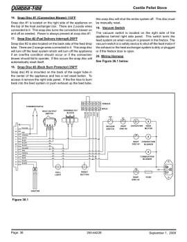

The Castile has two thermo switches that guard against high heat related problems one is the burn back snap disc mounted on the drop tube this is the manual reset switch, the other is an automatic reset high limit switch.
It is a pain to reset the manual reset switches as they do not provide a good feedback. I can not reset my manual reset switch without using a screwdriver tip, fat fingers I guess.
Your manual reset shouldn't have tripped unless here were burning pellets in the drop chute, it was more likely that the auto reset thermostat override switch (I kid you not, that is what it is called in at least one Quad manual) cooled off enough to reset and allow a restart.
Look them up tj you'll split a gut laughing.
ETA: I just uploaded the verbiage about the #2 snap disc in one of the Castile maunals. It is a fuel delivery interrupt switch there.
