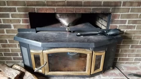

This is my first thread. I'm lost on what to do to heat my house. I recently bought a earth stove insert from a co-worker and thought that was going to solve all my heating issues this winter (HA). After installation of the insert, I found that it would hardly heat my 500 SQ FT finished basement room. I did some research and found that I would need to install a chimney liner. I just recently did that and still nothing. I'm not sure on what I need to do to get heat upstairs. I would love any advice if anyone is willing to give it.

Do you have an insulated plate sealing off the space around the new liner to prevent heated air from going up the chimney?
Do you have insulation behind the insert?
Is the liner insulated?
What moisture content is your wood?
How are you running the insert?

1) I do not have insulation behind the insert. I honest did not know I needed to do that.
2) The liner is insulated.
3) The wood has been dried for a year.
4) I'm not sure what you mean how i'm running the insert? I have sometimes have it going full blast and other times I have it on low where it's burning slowly.
What sort of plate would i put in above the insert? Would it be something sheet metal?

1. You don't need insulation behind the insert but it will help keep the heat in the house if the fireplace is on an exterior wall.
2. Good that won't help with heatoutput but it is much safer and will make it perform better.
3. That may be dry enough but probably not.
4. I mean what do you do. You should be loading it and then running it wide open untill the wood is fully involved then shut it back pretty hard.
5. Yes sheet metal with a fireproof insulation on top.
Oak is not dry after a year unless it had exceptional circumstances (solar kiln, under a roof in the desert, etc). Topcovered, it is usually suboptimal after 2 years and dry after 3.
Wet wood and no blockoff plate are my two guesses. You can fix the blockoff plate in an afternoon, but not the wood.
Get some pine or fir in now and it will be primo by next fall.

The liner is sealed off. I just went to Lowe's and bought some of their firewood just to see. I did see a slight difference in the room itself.

That wood may not be dry either. It is only run through a kiln long enough to kill bugs. You need to get s moisture meter
The Earth Stove calls for an 8" liner no?
How tall is the liner?

  • [Hearth.com] Lost with my Earth Stove insert
Someone else notching out the appliance adapter for the damper rod.
That is a Bayview B400C. Very cool stove, one of the first hybrid catalytic stoves that is all the rage now.
You will need to pull the cat and probably get a new one, or at least I would recommend that, you can vinegar wash them.
http://www.manualsdir.com/manuals/83614/earthstone-earth-stove-bv400c-2.html?page=17
I would also recommend insulating that fireplace as that will eat quite a bit of the heat, see below for how to.
If you pull the cat you will want to have a new cat gasket on hand to put it back with.
