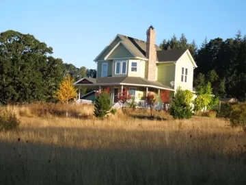

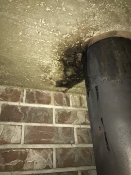

We have 2008 Quadrafire wood stove attached to a brick/masonry chimney constructed @1997. About 2 years ago we began to get drips of water hitting the stove. They appeared to be coming from the intersection of the metal chimney pipe and the clay flue. It got bad enough that last May we hired a company to look at it. They replaced the cap with a "Monsoon Cap", sealed the crown and cleaned the chimney. As the weather has cooled we started using the stove again and the problem is much worse. 3-4 cups of water are coming down within 30 minutes of lighting the fire. The water is coffee colored and smells terrible. It eventually stops but it can take hours. I'm still fairly certain it's coming down the inside of the flue though the staining is so bad it's hard to tell. The problem is worse after rain. The chimney is tall, over 30' and the roof is really steep so it's hard to get up there to see for myself.
I really don't know what's going on. Water seems to be accumulating somewhere and heat from the stove is letting it drain. This is worrying because it's a new problem and seems to be getting worse. I'm a little gun shy about calling the same company again and being sold another solution that won't work. I'd appreciate any help anyone can offer about what might be going on or how to get it fixed.

After looking at the verticle section of pipe again, it appears that your pipe is installed backwards with the upper section over top of the lower section. That condition does not necessarily account for the added liquid after it rains.
