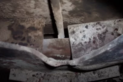

Most likely a weld gave loose. This happened to my stove several times before the bypass plate completely came off of rod. I started having these pops and bang the last year I had my stove. When I removed the stove and was able to inspect the interior better I could see where several welds had popped loose and I had some cracks. My stove was over 25 years old and was over fired several times before I had moved into my house. I could tell by some warping on the interior baffle plates. I would make sure to inspect it to make sure you don't have any cracks that have opened up.
