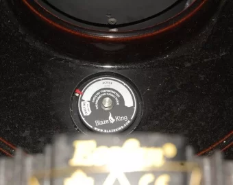

Attached is a pic of the cat probe at the point I have settled on for engaging the combustor. There are some small white cross hatches on the outer white ring of the cat probe. As pictured one of them is under the red needle. I find if I engage the combustor here I am far enough into the active zone for the combustor to light off quick when its engaged and the cat probe indicated temperature starts rising pretty quick. I have tried engaging both a little higher and a little lower, this seems to be a pretty good spot for me, my gear, my wood and ambient temps around maybe +35dF average. Plus its easy to remember.
