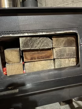

Ill post a picture of an overnight load when i get home this might help people understand what it takes to get a good long burn I’ve been looking at peoples fires on this site for years shaking my head and they wonder why they only get a few hrs or no secondary action, i get rough cut 3 by9s from work i can put 2 rows of 3 in on the right side and middle of the box then a row of 4 by 4s on the left and essential get a left to right burn that’ll last all day or night and I’m heating 2300 plus feet from the basement, picture coming later good afternoon gentlemen,
Here’s a picture of a full load for my stove this will get us 10-12 hrs of heat because it’s kind of mild out 35 degrees Fahrenheit if it was colder it could e down to 8 hrs but usually when it’s below 15 I’ll do slightly smaller loads and burn a little hotter good night

The solid wall with little air gaps between helps the longer burn. What species wood is this?
Those are oak shoring timbers I get all the cutoff pieces at work takes a while to dry I even put drying sticks between them for air flow under the solar kiln otherwise it’ll take 3-4 yrs to dry

Wow that is tight, Don't think i could get away with packing it that tight in my set up. My draft is ok but not overly strong in any way.
Years ago I use to buy cut offs like that from a pallet making company. $35 for roughly 1/3 cord. It was a sad day when they went out of business.
That wasn’t a cold start I had some coals I raked all the way to the left then added the wood and the 4 by 4s took off fairly fast so really there’s nothing under the big boards which gets me a nice long burn essentially left to right till the tops catch then it’s a top down fire works well for me , everything I learned I learned here at this site been reading it for years finally got on
