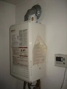

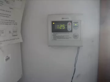

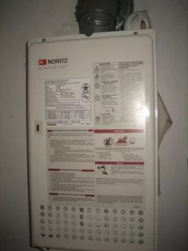

I have a Noritz and have had it for 3 years now, it does great. I have the 6.2 gpm unit because there is my wife and 4 kids so there may always be a couple of people taking a shower at anytime. You could probably be just fine with a 4gpm unit. Ours was purchased from www.irawood.com. I dont thing they sell Noritz any longer but I dont know why.
The service was excellent, they are in Kentucky (I am in northern Indiana), ordered it one day and the next day it was here.
If you are going to wall mount and use a short exhaust, be sure to get a backflow preventer, standard on the Noritz it will keep the wind from getting in and freezing the unit up when it's not being used. One point to help save some $ If you are going to buy a Bocsh, get a Takagi. Takagi makes the Bosch, puts on a different sticker then Bosch gets a little kickback for selling it as their brand.
