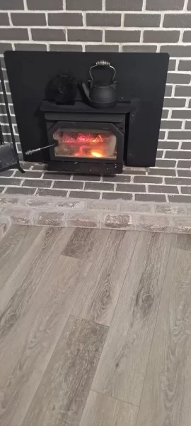

Greetings I am new to wood burning stoves. My wife and I bought a Ironstriker c160. It's a tiny stove and works well for the little house. I have a question regarding LVP planks being installed in my house and they go up to our brick hearth which is 18 inches away from our stove. My question is does anyone know if the LVP planks will get damaged or warped if they get warm to the touch right up against the last brick on the hearth. I can't find any info on this question in the store or internet. Does anyone have LVP planks near their wood burning stove and if so how is it working out?

How hot does the floor get? I have a stove on a hearth with aminate and my floor stays cold in front of the stove.
Is your LVP a floating floor? Is there a gap all around the perimeter? If it's supposed to be floating the temperature might make it expand so the perimeter gap allows the expansion.
Does the hearth extend at least 18" in front of the stove door? It looks like this might be a little shy of hearth protection for the stove. For peace of mind, put a hearth extension pad or at least a hearth rug in that area. If you have any pets, that will become their go-to place in winter.
I have a hearth extension, then a floating laminate floor. It does get warmer in front of the stove, but no expansion or other issues that I’ve noticed
I second the hearth extension pad advice. I have 18 inches of hearth extension but my wood insert calls for a certain R value of hearth that i couldn’t confirm. Plopping the heart extension pad over the existing hearth extension did away with that concern.

Hearth and Home Technologies does not recommend adhesive-based vinyl flooring due to thermal expansion. Floating-style flooring (LVP - luxury vinyl plank or LVT – luxury vinyl tile) can be used, but it will reach temperatures up to 110 °F in a room with an ambient temperature of 70 °F. Consult flooring specifications to ensure compatibility. When using LVP/LVT flooring, HHT recommends wood stoves and inserts have 57 inches of alternative flooring in front of the stove or insert before using LVP/LVT. Whether the stove or insert sits flush on the floor or is elevated on a raised hearth, 57 inches of alternative flooring is required in front of the stove or insert.
