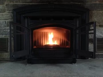

I'm attaching a picture from this morning, on Setting 5. [smoke stains on stone above stove are old and unrelated to the stove].
  • [Hearth.com] M55 - disappointing results
