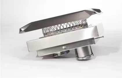

I also found this cap which supposedly allows for both venting and make up air. Not sure how they're kept totally separate, though. http://www.firesidechimneysupply.com/13-chimney-caps/co-linear-chimney-cap.html
Assuming it works, this would have the benefit of keeping exterior (cold) air out of the chimney. Your suggestion would too - but only to the extent that I could really effectively seal off the stove (while allowing the vents to go through).

Didn't I see somewhere on here that there is a single pipe which accommodates both exhaust venting and OAK, with one line running inside the other and the exhaust prewarming the combustion air for greater efficiency? IIRC, this might be a solution for you.
Selkirk dt venting.
Selkirk dt venting.
Hey Bob, thanks for filling in my memory gap! Embarrassing, especially since their ad is at the top of the page!
