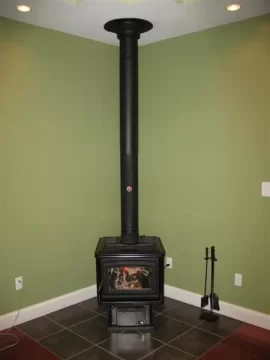

How would I know by looking if the stove connector pipe is OK? The paint seems to be fine. I have one of those small sections with the damper built in right on top of the stove.

ok , i misunderstood your first post when you were talking about the paint on the pipe smoking, i assumed that with 1400F and smoke billowing off the pipe that the paint had cooked off of the pipe.

Well, maybe it wasn't the paint but something sure as hell was smoking like crazy from just above the stove. It looked like a KISS concert.
