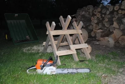

After work yesterday I decided to make a sawbuck with some wood I had laying about. I just pulled some plans from a site online and tossed it together. It turned out pretty decent for a quickie.

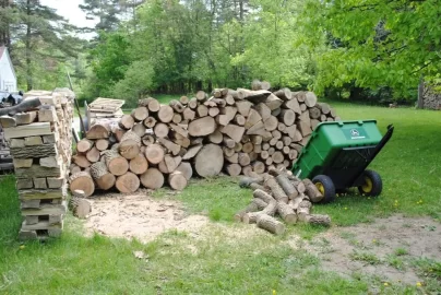

I had a bunch of ash I needed to shorten and didn't want to deal with cutting on the ground. Today I put it to work, here are the results.(I figure it's around a cord)
Now I just have to split it! :lol:

Looks good rdust, I built one with plans off the net but I have not used it yet. Do you burn a lot of ash?

I burned a little more than 2 cords of it this past season.(yep I'm calling it past now!) With all the dead/dying ash tree's around I'll be burning it as my primary hardwood for the next few years. After I get what I cut to length today split I'll have about 7 or 8 cords of ash put up.

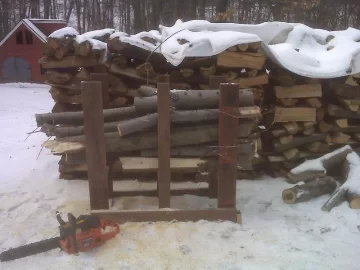

I built this style sawbuck last winter and I really like it. I do not know how you guys do not hit the horizontal boards when bucking with the typical sawbuck and it cannot hold very much. I can load this simple sawbuck style up with wood and cut down with no fear of hitting my sawbuck unless I go too far left or right. I use it mostly for branches that I load up to 2 and half feet deep and cut them all at once. Something to consider.
I like that one a lot, did you find the plans on the internet or is it your own design?

Ja, it looks like it can hold a lot of wood. I thought of building an H style over the more conventional X style. Also thought of building an asymmetrical X.
No issue of of hitting anything so far

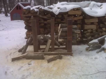

I like this design; would be interested in getting some plans for that if you don't mind. I built one from internet plans last summer and did find that it's very easy to cut the horizontal but that was due to the design. Horizontals should always be just below the intersection of the crosses. My challenge is to have some type of jig on the buck to line up all the smaller pieces that just need one cut to take off 4 - 6". Mine does have an adjustable cross member which slides along a horizontal pole, but it's really not the most efficient process.
Thanks everyone. I had a post on this in the winter that had my plans. Unfortuneately all of my posts got deleted accidently by the webmaster (craig) when he was deleting some spam users. He got me by accident. I know I saw a video on this design on a website that was selling a metal one (which is not good if you hit it with a saw). It looked really simple and I had an old Red Wood table so I disassembled it and rebuilt it in this design. Really simple, I just made the H's spaced so that the center would be 20 inches apart (my preferred log length). Then I put a support 2X4 around the entire bottom. I also connected the H's at the bottom for more support. It is amazing how much wood you can hold in this thing and when you cut down you end up with a pile of logs in very short order. I did not mean to hijack this post, but I think you guys will like it. The attached picture shows a pile of logs once they are cut.

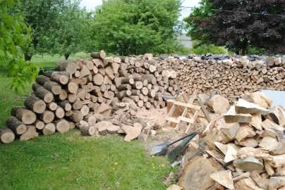

I threw this together out of scrap that I had around a few years ago. I set it up for trimming scrounged wood to my optimal length of about 17". I can load both sides and cut a bunch of rounds or splits in one pass each end.

It is plywood and 2x4s.
Flatbed, I like this design, looks like the horizontals can be nicked/cut without major comprimise.
