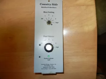

Wondering if anyone has any good settings for burning pellets in the Bio-Fuel pot? A dealer recently told me to try 6 and 7 on nob setting #3.
Have read through the tech bulletins and info on AES website and they discuss setting it on 1 and 1 for draft and fuel settings on rotary nob heat setting 1.
Looking to squeeze efficiency and a bit more heat out of this stove.
Also, has anyone tried running one off of a thermostat with any luck?
Any input would be great!
Bumping this thread to the top. Tried setting back to 1 and 1 for draft and fuel, seems to burn good so far from setting 1 to 3.
Hopefully others will chime in with specifics for the Magnum Countryside....
This is the only board I know in the Magnums. The fan speeds increase by the board with the feed-auger setting. Fine tuning is then done with the slide damper. If getting to much air even with the damper in may have to trim the lower corner of the slide.

Thanks for the tip Bio. I have trimmed the lower air slide, a while back has helped with getting more heat out.
It was my understanding that the higher the blink setting on draft the faster the draft motor spins. The higher the blink on fuel, the less the auger feeds pellets.
I was reading though that when you change the draft setting it also changes the auger setting.
So what is the point then of having two adjustable trim pots?
It also seems that if you adjust one setting, that one setting on the board is the same on all heat settings.
Stove might have older technology, but it is pretty easy to work on and there is lots of tweaks that can be done.
As stoves have different installs, one trys to set stove up to meet those variances. Fuel differs widely especially corn. I am burning 10 percent moisture, 63 lb.per bushel corn. Never said the settings on thier stove makes much sense. Promo for stove claims 23 years. How long would Ford or Chevy last if they didn't change.
